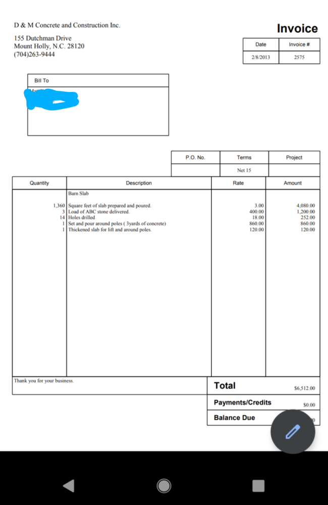

Concrete for my 34x40 shop was $3/sqft finished including labor and material in 2013. And they augered 14 post holes, set, leveled, and braced the 6x6x16s. And set the wire and rebar that I supplied for free. Total for a 34x40 was $6500. Even includes finish grading and gravel under slab, and 2 loads of gravel for the driveway and parking area.
Welcome to Charlotte 2020.
Yeah, that's not fair.
