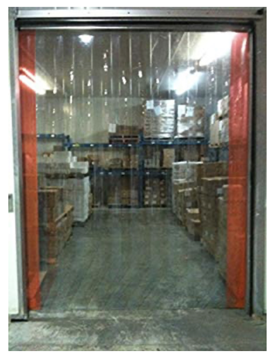

How big is your garage door?
This solves that problem.How big is your garage door?
It doesn't really matter. Just assume that it's a R-5 panel about 24'x7' with the air infiltration of an equivalent size 100yo single pane wood window.I'll have to go look that up, I can't remember what size they are.
@shawn is right why over insulate an area that isn’t going to be a living space. Garages don’t need to be heated all the time and it’s going to be separate from your house envelope.
You be better served doing a stud wall 2x4 or 2x6 used maximum standard batt insulation. And put money towards a better garage door/ garage door seals & weather stripping
I wouldn’t even use 2x6, just use 2x4 and be done. It’s a garage.
