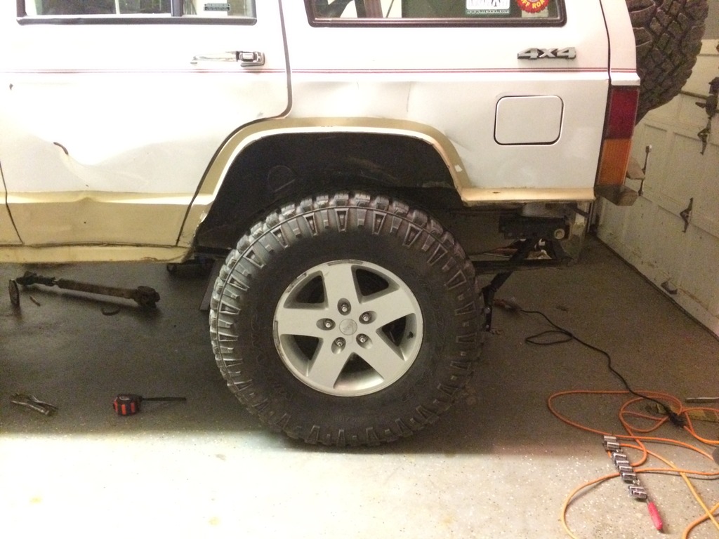

Basically the stretch is to center the tire in the wheel well. For 35s now it is pretty trivial to stretch the rear axle but in a time far away hopefully a 40" tire will be in there. The wheel well will still need some fab but the main reason is I have 14" bilstein shocks that need to go through the floor.
I only want to weld the shock hoops once so I need the rear axle in the correct spot for future jeep plans.

I am looking to cut holes in the floor this week so I took everything out of the back. The rear of my jeep raised almost what felt like an entire inch with no weight in the back :eek:. I noticed there isn't as much room around the wheel wells like I thought. The back seat really intrudes in the area for a hoop. Also with 14" shocks almost 12" of the shock body has to stick up through the floor which I wasn'te expecting.

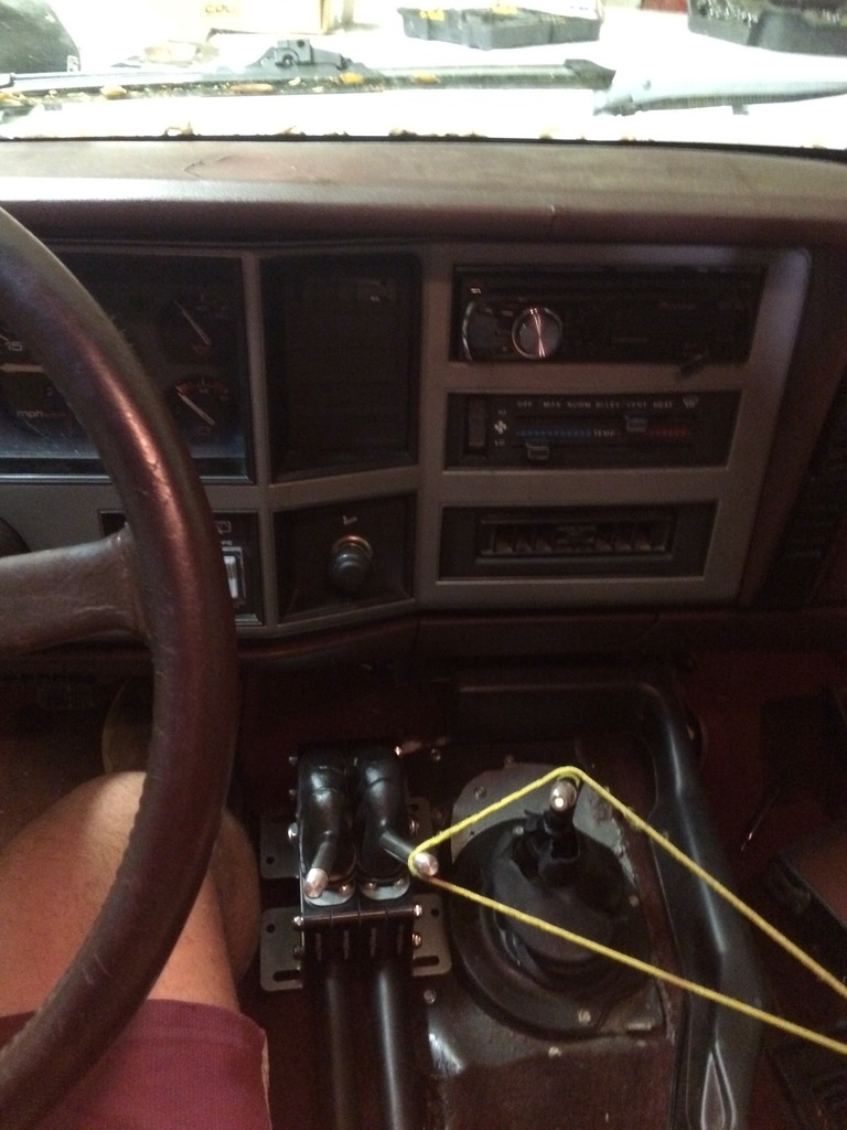

These feel silky smooth. Definitely going to enhance the twin stick experience and worth the extra dough. However I had no idea just how big they were. I am also glad I went with 48" cables. 36" cables definitely would have been pushing it. In the pic below you can see just how tight things are starting to get inside. The rear of the shifters are also long and in the stock shifter position the rear would hit the dana 300.
I can't push them to far forward or else the shifters will hit the bottom of the interior dash panel. I will try to sink them into the trans tunnel but can't go too far until I hit the trans. Definitely going to have to get creative here.
