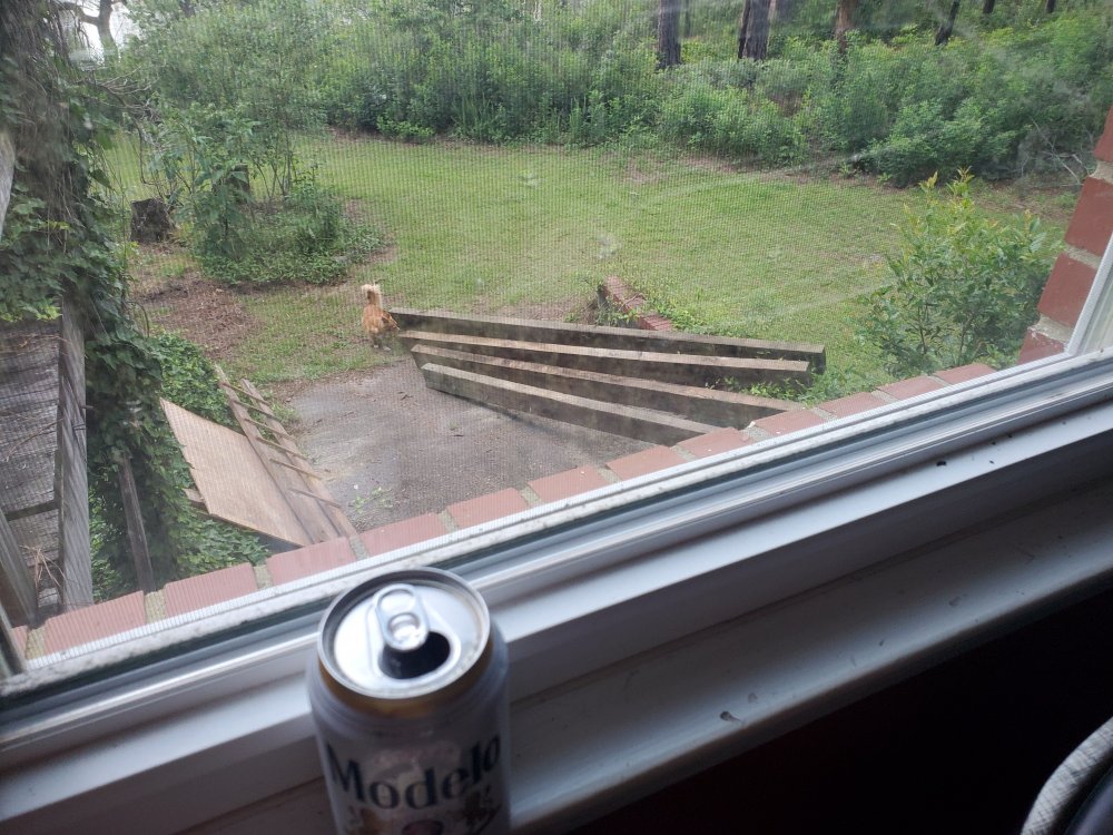

Exactly! Didn't fall through a flimsy trailer floor. [Even though it scared the poop out of you] Looking at your post supply, I'm not Impressed.
Looks rotted, cracked, out of square, twisted? And going in a humid basement. The ants & termites, might throw a party!
Ok it turns out that 6x12s are really heavy anyway. I grabbed some 4x6s to use.

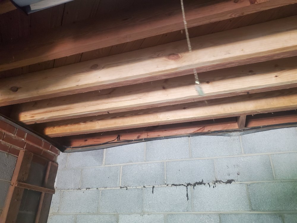

I’m pretty sure a slab is non-load bearing. If you were concerned about weight transfer into the floor from the joist into a Jack-post. There needs to be a footer.
I posted this with no actual knowledge
If he spreads the load just a little bit on the slab he should be fine, so long as he has a semi decent subgrade. Even cheap concrete is 3000psi

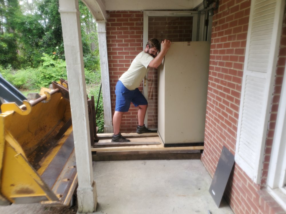

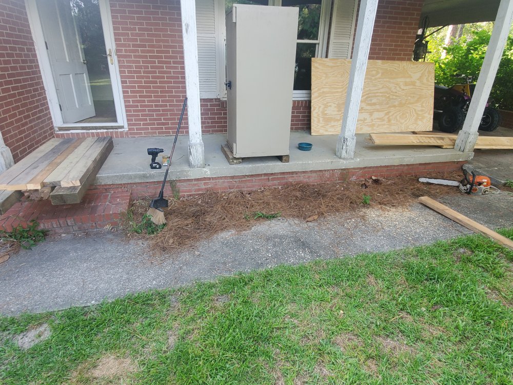

Anyway, I have access to a backhoe with forks and should be able to get it out of the trailer and onto the concrete porch but I don't know what to do from there. I called a few localish movers who do not want to move anything this heavy. A safe store in greensboro quoted me $900 to make the 1.5 hr drive and that is more than I spent on the safe.

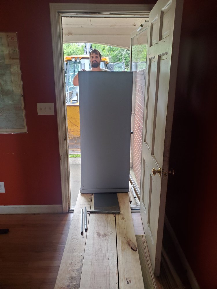

From the concrete porch there is about a 6" step to get through the door. Once the safe is through the door I just want to slide it along the wall about 20ft and there it will live, sitting as close to the block foundation as possible. The floor is hardwood and I am pretty sure it can handle the weight, but let me know if anyone disagrees.
I've researched a lot of forums where people moved safes but they were all half the weight of this one or less. A popular idea seems to be golf balls or pipe rollers but I've not found anyone who used rollers under a safe over 1000 lbs.
Right now my only idea is to build a platform on the porch, set the safe on it then slide it in by pushing it with the backhoe bucket. If that works and the safe clears the door I do not know how to move it perpendicular to the door opening and get it to its resting place. Any ideas?
I went to homedepot and got Floor jacks to support my drake safe
Concrete blocks and 4x6 to span the joists

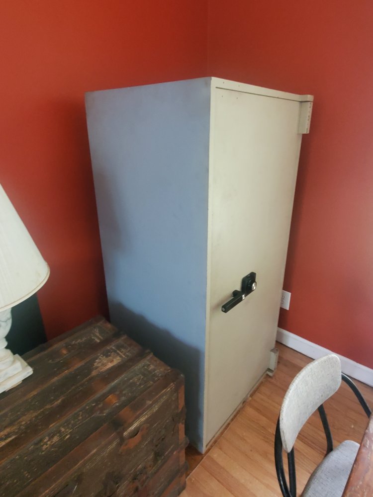

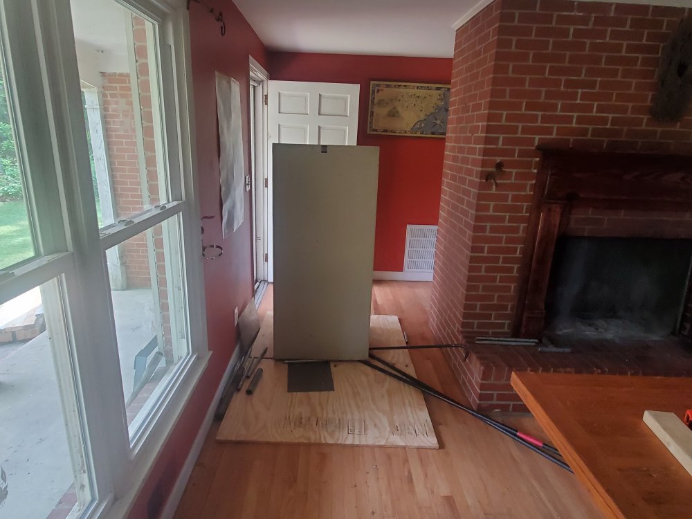

Its in. It took 2 hours and was pretty easy. The hardest part was getting it off the forks and that is because it took me a while to realize I needed bigger diameter pipe as a roller for that part.

Heck yes! Though I'm honestly a little disappointed it didn't crash through the floor because that would have made a great story.
