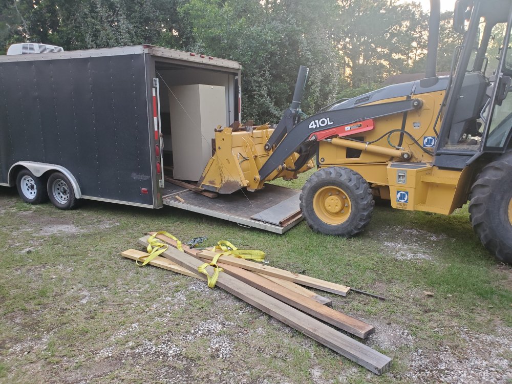

I will not be bolting it to the floor. If a group of theives experienced in moving heavy safes shows up with a wrecker they might be able to get it to the door and winch it up but they are not getting it onto a trailer or truck bed with 'normal' means.
It is out of the trailer.

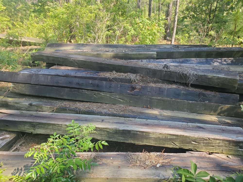

The plan is for the sistered joists to transfer the weight to the 6x12 beams I posted a pic of earlier, supported by the concrete slab in the basement. Do you think I need something stronger than 6x12s?
