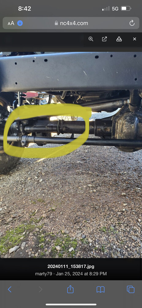

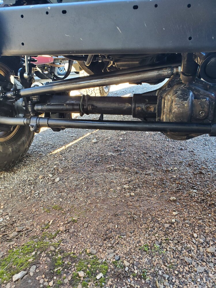

You can see the pinion is way up in that pic. That indicates your caster is way off. Set the caster to around 6* (this will lower the pinion angle). Report back.
Its parallel with frame/ground but I'll give it a shot, that's 2 for caster now
Wtf is this?
Started to mount the factory stabilizer but then stopped cause he started asking about hydro assist and stuff lol
With 5 degrees of caster, my pinion still has some upward angle to it. It'll be fine.
How the heck? Mine is perfectly parallel with frame/ground and it reads 4.1....Ford tech told me to check it on the Tie rod knuckle...on top of the C right next to spring mount it reads 8.8 but on the Tie rod mount it reads 4.1... I'll double check again
