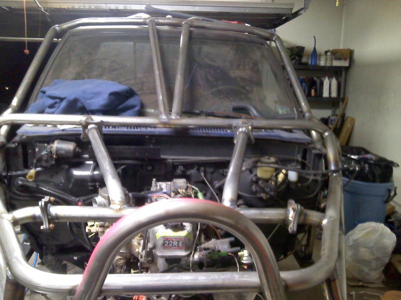

sorry been working on the front axle and tryin to get all the wiring done since im not using a factory harness i have to make it all. ill be out off town this week on buisness so hope ill get to work on it this weekend and get some pics up.
pics

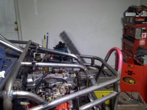

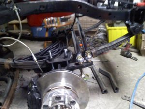

here a some pics i took before i left.

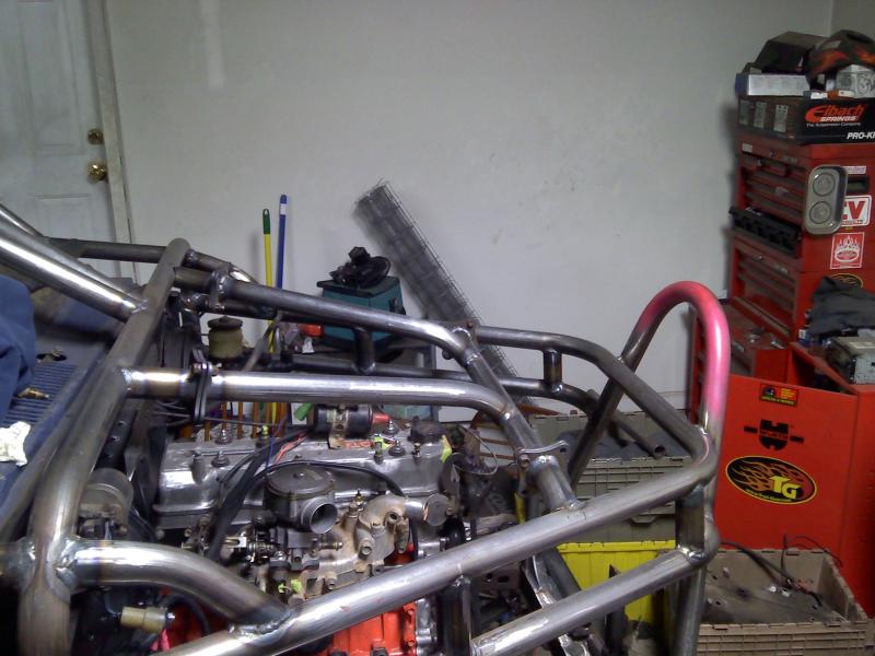

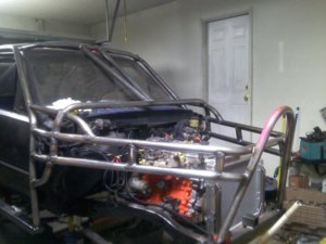

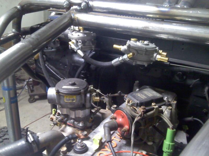

some more updates

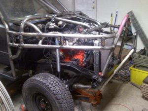

the hood still have to add the aluminum to cover it.

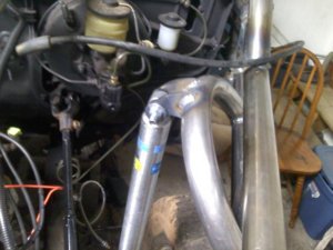

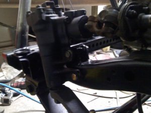

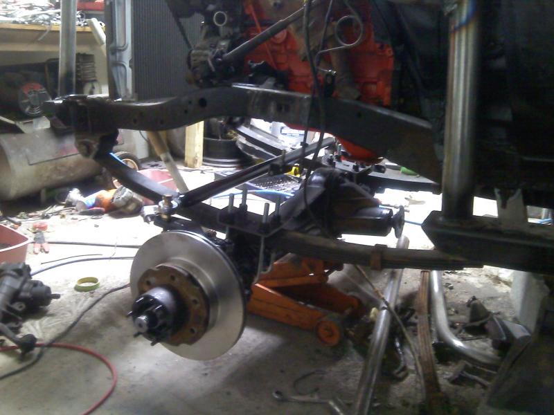

steering box mounted. sleved the holes in the frame and made a bracket for the top bolt location.
tie rod and draglink installed 1.5" DOM .250 wall with 3/4 heims.

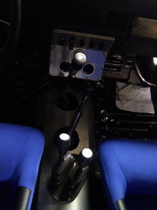

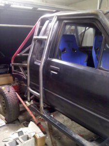

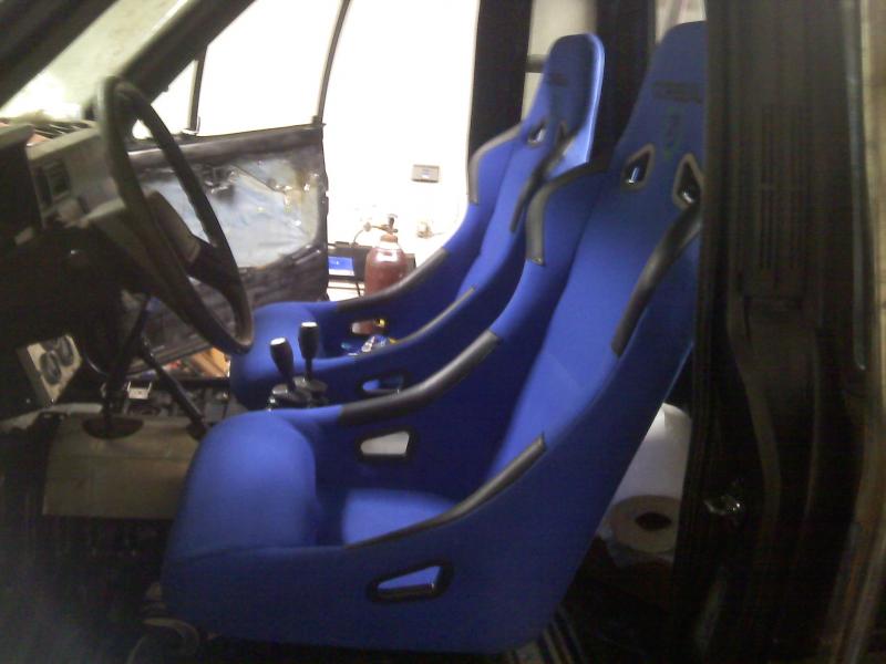

i guess you got the seats mounted... the corbeau mounts are still on backorder. i need to call and cancel those this week. looks good
im not sure if i missed it or what but are you runnin 2.28/2.28 cases or 2.28/4.7? this looks awesome. lucky wife you got there to be wheelin this buck wild yota
