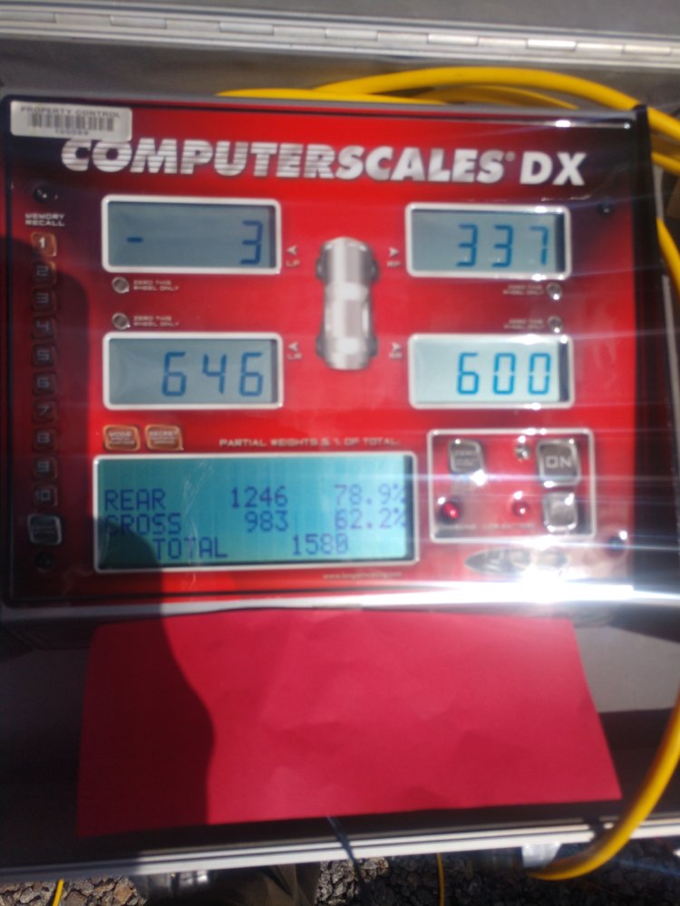

Well trailer weighs this much..

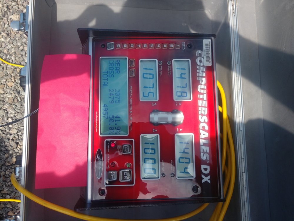

And my rig weighs this much full of gas and tools...add 177 with me. Not bad, I expected to be way more
So now it will get 2x8 floor for sure knowing I'm total weight way under 8k.
Also tells me I had WAY too much tongue weight towing last weekend seeing now the weight distribution of the rig is only 400lb more in front, I only need to be forward of front trailer axle just a few...
800lbs in front. Gotta add both sides up. That’s 20% heavier in front.
I think I see why the trailer shimmer a bit...that left front is full of helium
I'm not getting the joke but...the heavy dana24 is more towards driver side, gas tank and steering column/gauges and few extra cage pieces are also more driver side so that's reason for the weight being off..oh yeah pumpkin too obviously
I'm lost..front total is 2400 rear total is 2000 so isn't the weight distribution difference just 400 on trailer loading or am I still missing something
Your rear total is 2075
Your total weight is 4957
4957-2057=?
Your left front trailer tire weighs -3 lbs
Helium floats
So since the tongue weight is 331lb, I need to load Jeep to where it's only adding just few more hundred pounds right? Since Tahoe says 500lb tongue weight..
