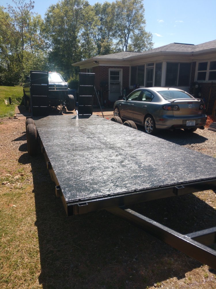

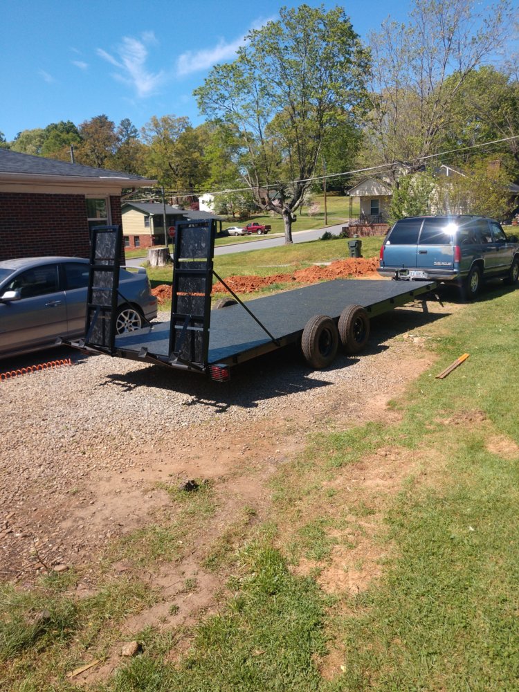

Well it's done, pulls amazing, doesn't feel too heavy empty. Got scales coming tomorrow to weigh the trailer and my rig finally.
3 thick coats of oil base Rust-Oleum on osb flooring for the floor. My rig will sit on the frame rails though lol. I like it.
Did you paint the OSB on both sides and all edges, or just the top?
Are the tires touching the sides of the trailer? You wouldn't expect it but the decking of a trailer is absolutely a structural member, especially on lighter weight trailers. Osb was a bad choice for a lot of reasons and that's a big one. Either way won't have to worry about bearings or tires failing first now.
:Edit: put some sides on it would add a lot of strength and make a good landscaping trailer for sure. Maybe some linoleum too.
I would expect no less.
Curious to see what it weighs. Any guesses John?
I'm guessing 1700 the way it feels empty behind a Tahoe which is the 7th one I've had lol so I'm pretty sure I'm close.
