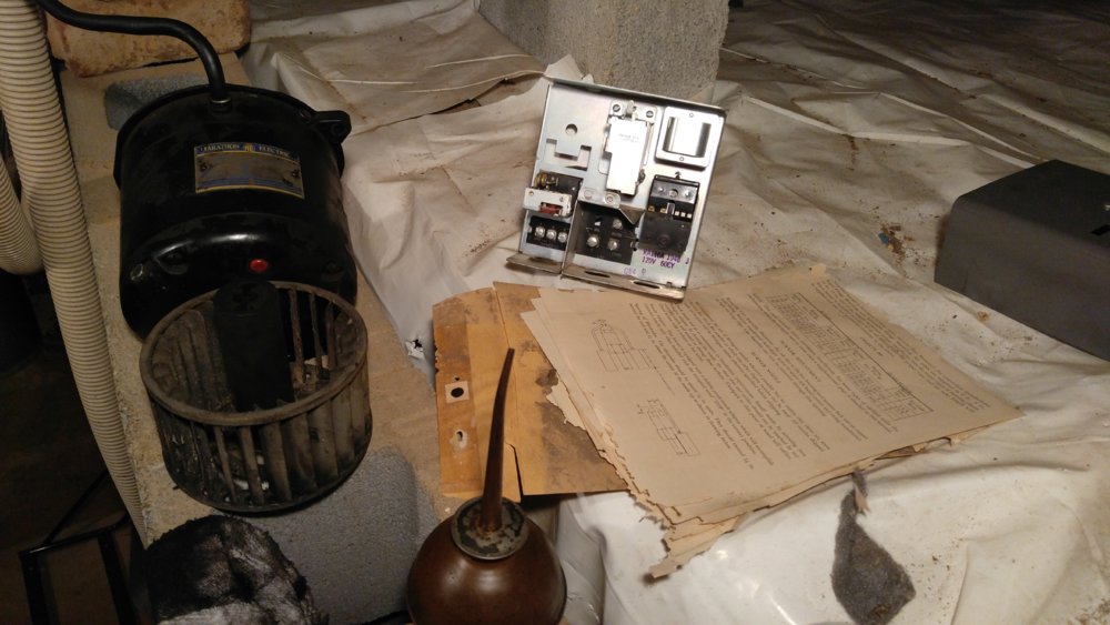

Almost completely understand the wiring and stack control.....with a AC unit and "water boiler" mixed in for fun.
And last but not least swapped out a newer motor. Reusing old couplers and squirel cage fan for Supply. Cause this bastard was my problem all along.
It finally dawned on me the start up Stumbly flame Short run Shut down was the motor control kicking out.

All of it was filthy and out of spec. Ended up putting a .25 an hour smaller nozzle. 1/16 smaller motor. Was all old left overs from the father in law. Being a horder and constantly patching old stuff along has some benefits. He also suggest just welding a bottom in the boiler to squeeze out some more time.:(o_O:poop:
