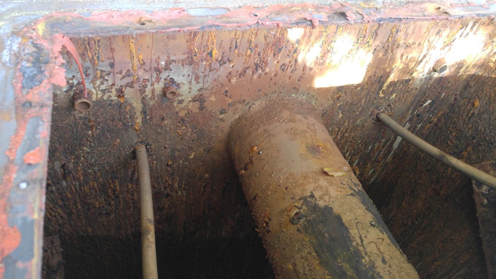

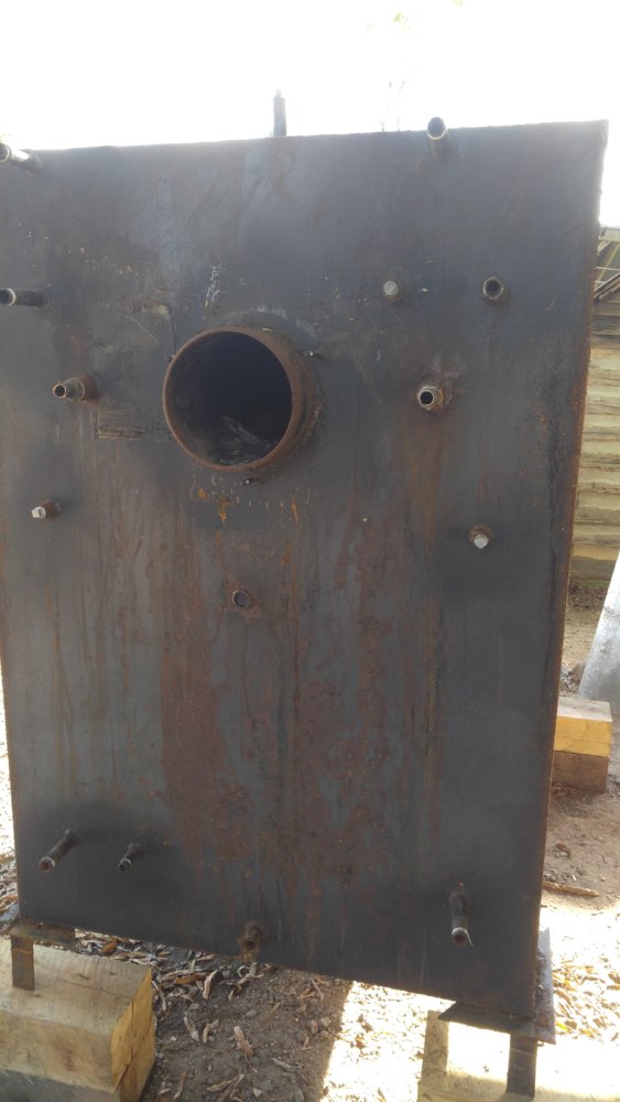

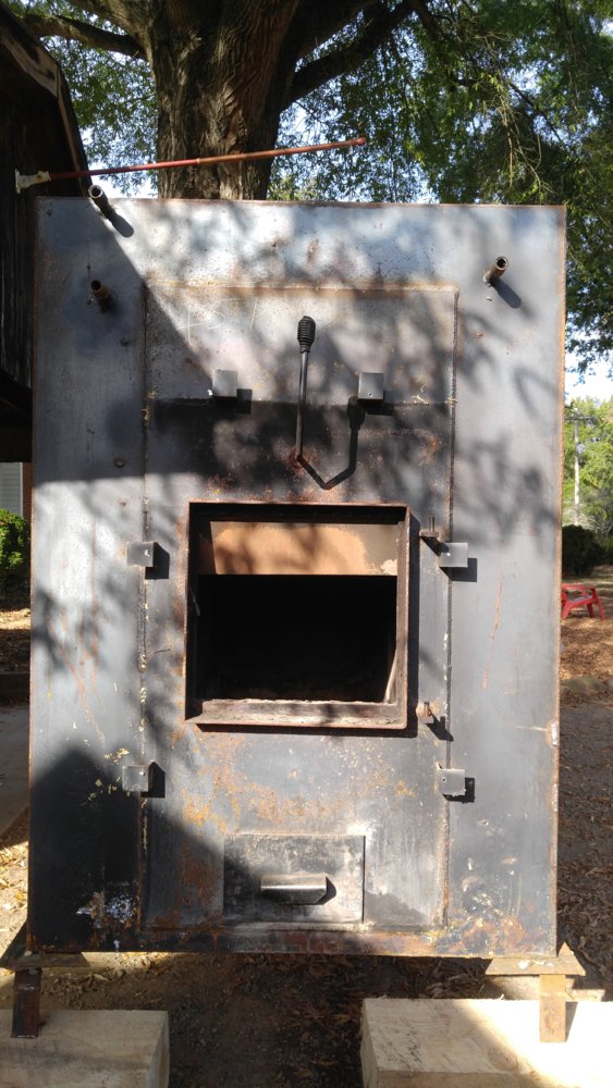

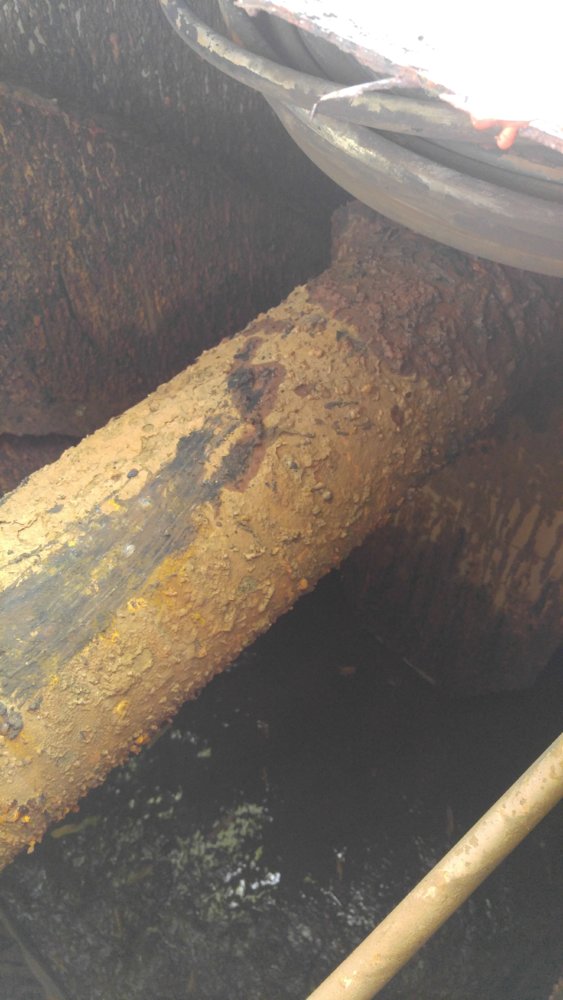

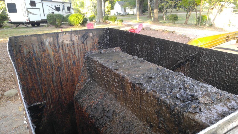

Me and the family removed the water stove. Carolina brand circa 1985. Bottom has through rust in several areas.
We rebuilt my father in-laws Hicks brand. Started with new bottom and extensive cleaning. Put it in service only to have all the flue piping rot out in one more season. Thinking I don't want a repeat of the same senerio.
So I'm debating new boiler unit? Complete rehash of the existing oil furnace? Or what?
