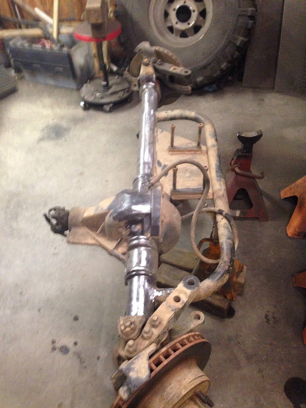

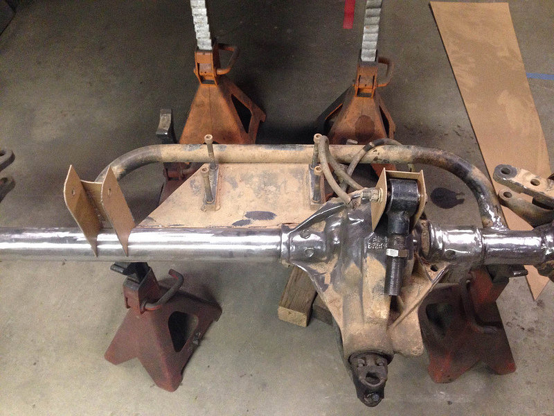

That turned out pretty good. How much adjustability did you build into the axle end upper mounts... or what results will they give you on the 4-link calc?
The axle end has 2", 4", and 5". The 2" is there so I can revert back to the original configuration if i dont like the new setup.
Im not sure how what how different the numbers would be at the 5" position vs the 4" I didnt run the numbers.

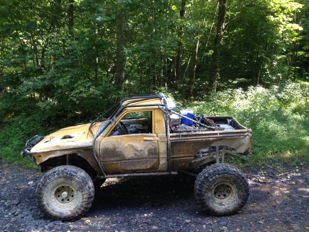

Since the last post here there have been some changes. Converted to propane, blew up 2 motors, got rid of propane for a 3rz, a new flashy mustard yellow paint job, LED light bar, sway bar, PSC full hydro, and most importantly some boat speakers for some tunes.
This winter I will redo the suspension with coil overs, new intake, and making more room in the cab.
Here is a recent pic from Ivy Branch.

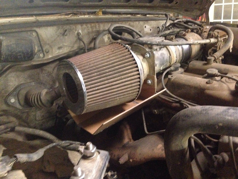

Mocked up a heat shield for the new intake I'm making. I need to find some 5/8 and 3/8 tube for the vacuum ports then I'll make the shield out of 1/8 aluminum.
