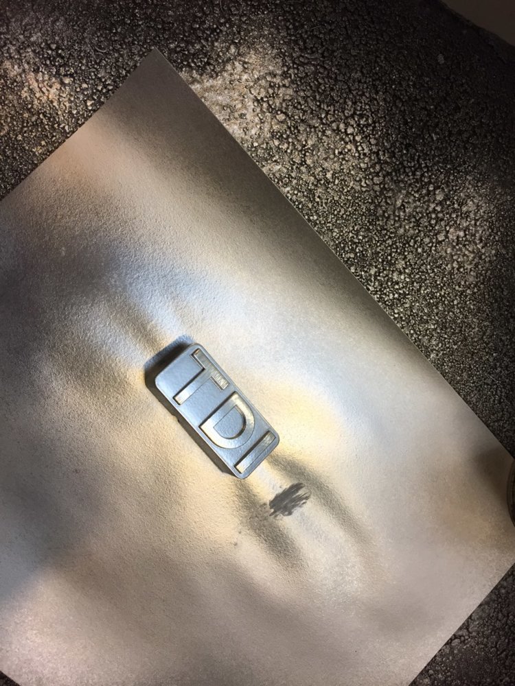

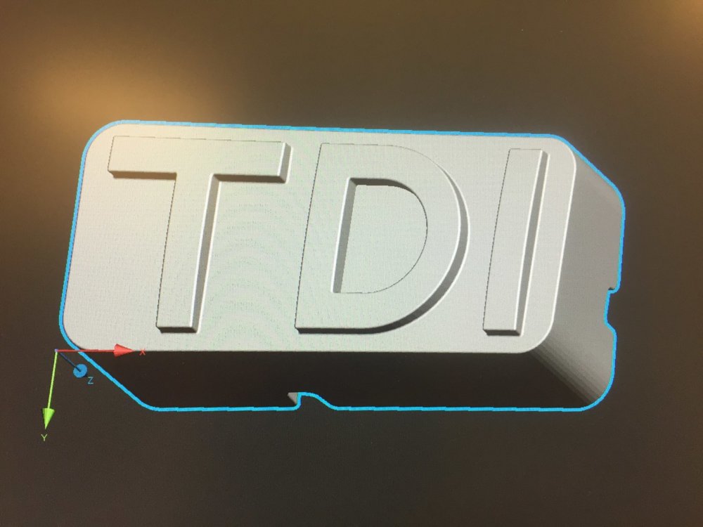

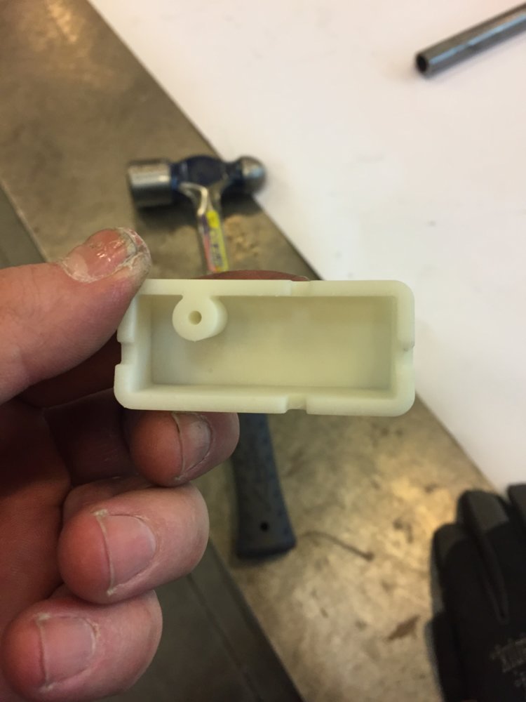

If anyone is interested in a TDI emblem to replace their V6 emblem, I have them for $35. They're free with the kit. You'll have to paint them yourself!

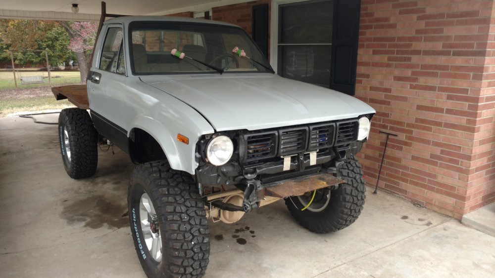

I have an 83 that a previous owner swapped in a 1.9 TDI. It has a landrover injection pump so no computer (I suggest doing that save save the wiring headaches).
I bought it with intentions to finish up and drive, but now buying my mom's house and I just have too many projects so I am going to sell it. I can say for a fact it is WAY better than any 22re I have ever driven. No comparison really. It has the landrover pump abd Beetle turbo, he said he thinks it should be 170 HP, but if I had to guess it is probably 120-130 but who knows.
This swap is WELL worth doing though for anyone looking to do it. (Or just buy this truck from me and use all the parts off it and part out the rest!)
