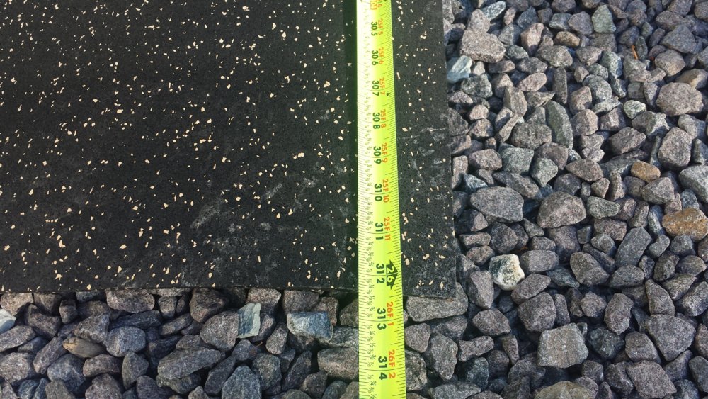

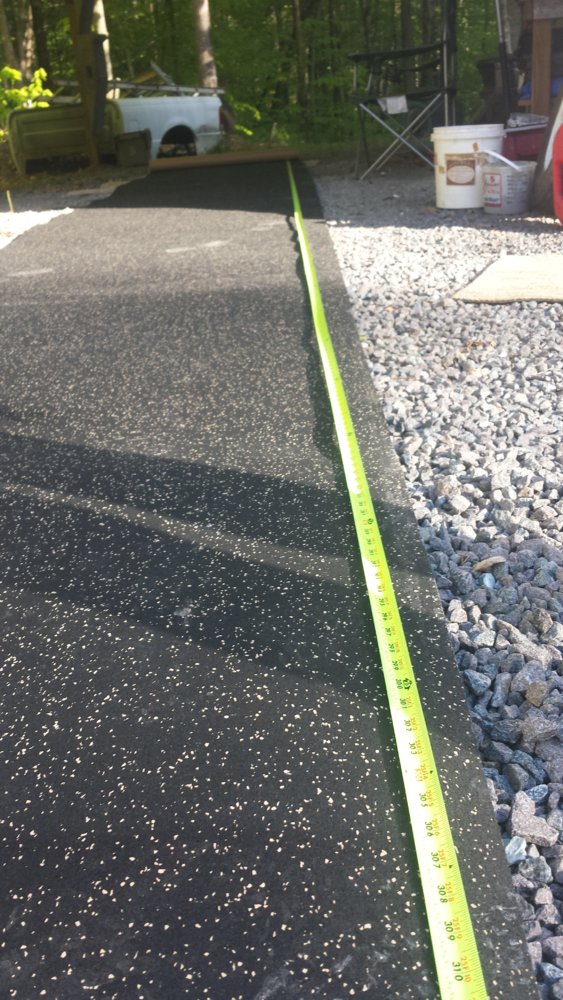

The tale of the tape
26 and a quarter
Actual....26.021 feet
Calculator...27.0417 feet. ==>3.9% over actual
Moi...25.92 feet. ==> .4% under actual.
