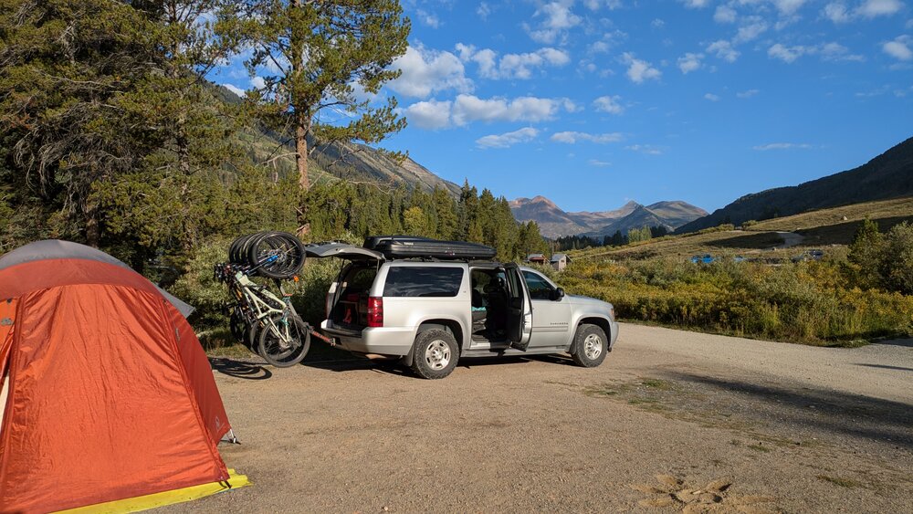

As my Bronco gets closer to being ready, I'm trying to keep in mind getting our tow rig ready as well. It's a 2wd 2011 Suburban LT2, 5.3 (dreaded DOD) 6 speed, 168k miles. I need to go through and do the brakes on it and get a trailer brake controller to go with the trailer I'm using. Not 100% sure on the entire specs of it, but it's dual axle, electric brakes, breakaway, etc. My step-father got it with an old Ford Tractor he bought. Should be more than enough to tow the Bronco to Uwharrie until we can shell out for our own. So beyond, the obvious brakes, fluids, brake controller. What things should I be looking into on this rig? I've heard the 6 speed can have issues so I should start saving to have an upgrade built when it goes. We've had the truck for about 40k miles and just kept up with simple maintenance, don't know the service history before we got it. I'm assuming I can't go wrong with a trans filter/fluid service (Not sure a full flush would be worth the time or cause more harm than good). This will be the first time I've done any towing with my own vehicle, I've always used others rigs before that were already setup/ maintained for towing so just trying to not breakdown on the first trip out because of something preventable. DOD seems to be fouling plugs from time to time, we had a miss after we had it about a year and the DOD cylinders had oil on the spark plugs, replaced them and haven't had any issues since. Maybe if the trans goes, it will be time to replace the cam and lifters, but that is a discussion for another day. I know it sounds like some stupid questions, just trying to be prepared and not be a burden on any group i'm riding out with. I appreciate any advice.

Trans fluid and filter change, don't flush. You can have the DOD tuned out if you're concerned about it, and a tune never hurts anyway.
Make sure you run good quality oil and change it regularly in those engines...
As far as the actual towing, does it have a trans cooler? I think they have a readout for trans temp in the dic you can scroll to. Keep an eye on the temps.
I have a friend that tows with a similar tahoe and it works fine but squats it pretty good.
Trans fluid and filter, no flush. Consider an additional external trans cooler in front of radiator.
I’m pretty sure there is also something about the trans cooler bypass thermostat. None of mine are affected but I’ve read about it being an issue. Not sure if yours is one that is affected.
Make sure it has load range E tires. A bunch of these generation 1500 suburbans have non load rated tires, meaning not even C rated.
Also consider a weight distribution hitch. Depending on options, your suburban may have decently soft rear springs with air assist shocks and an air compressor in the rear to self level.
If not going with a weight distribution hitch, make sure you have a good adjustable height hitch and try to make sure you get tongue weight correct. Weight safe even has hitches now with scales in them for setting tongue weight.
When it’s time to tow, use tow haul mode, and put the shifter in manual mode. This way you can keep it out of 6th, and helps the trans from hunting. I’m regularly using 3,4,5 depending on speed and grade.
Check the brakes on the trailer and a good controller goes a long ways.
I’ve had good results out of the powerstop brake kits that use drilled and slotted rotors and ceramic pads. These don’t glaze over as fast as oem stuff, and with your mileage, can be a worthy upgrade.
