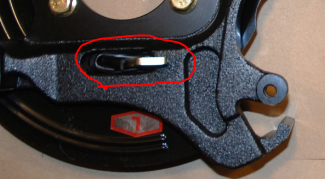

I am trying to source the parking brake lever for a TJ Rubi 44. Mine are frozen solid and can't be freed up and I'm trying to avoid buying an entire backing plate assembly just to replace the parking brake lever. Any clues as to where I can find one? I have attached a pic of the part in question.

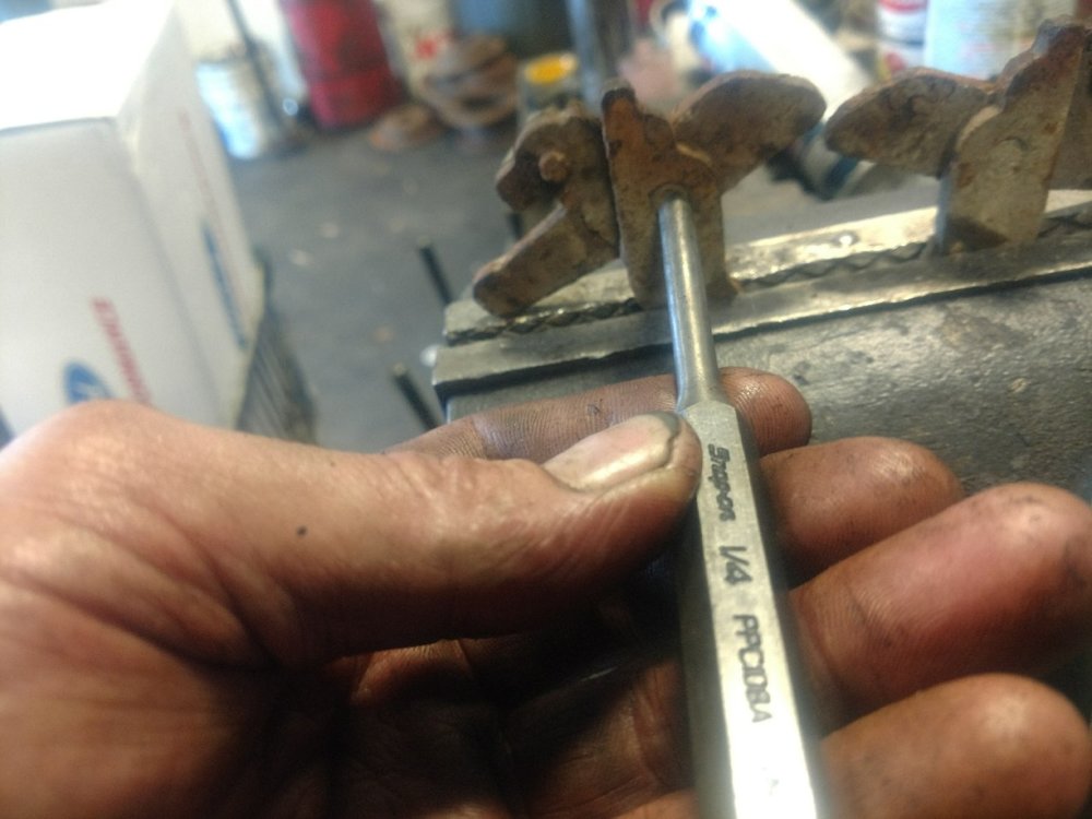

I actually ran into this today and took some reference pics!
Knocking pieces apart

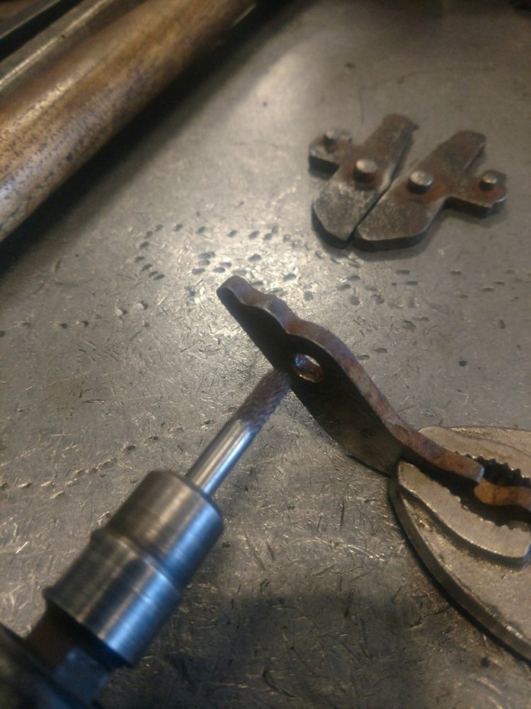

Cleaning up the hole with a burr bit, it just needs a touch to remove the rust buildup.

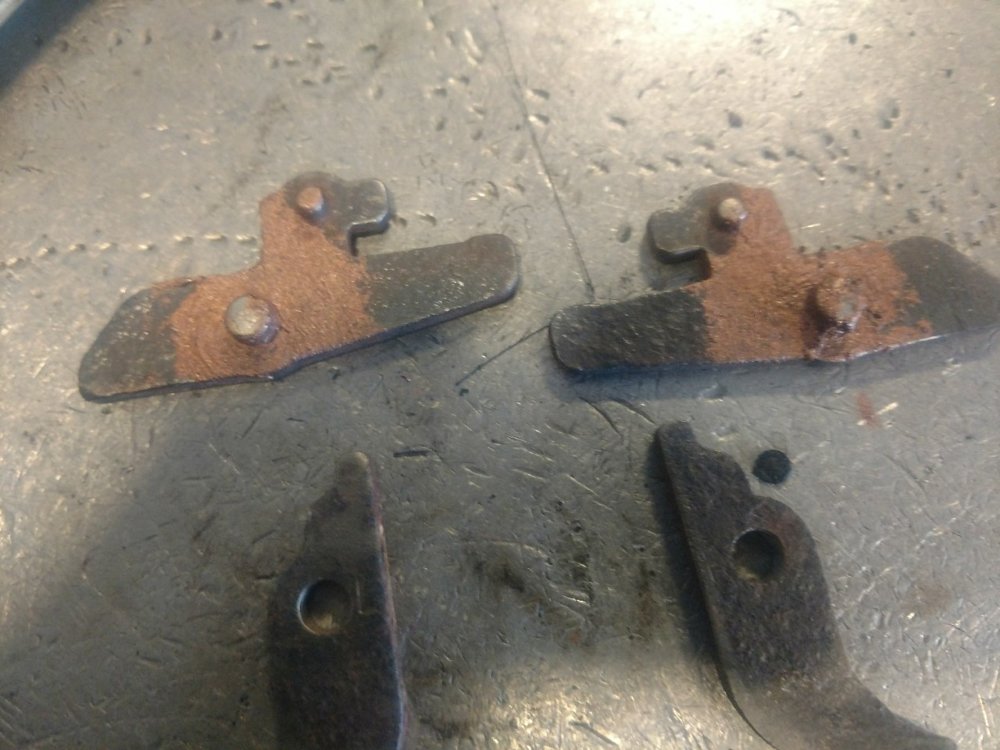

Anti-seize in your friend so this doesn't happen again!
