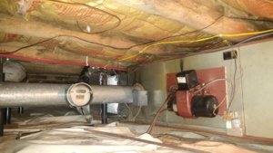

May I present Medusa.
She's a big noisy aggravating dollar eating whore.
She's old worn and a jig saw assortment of additions.

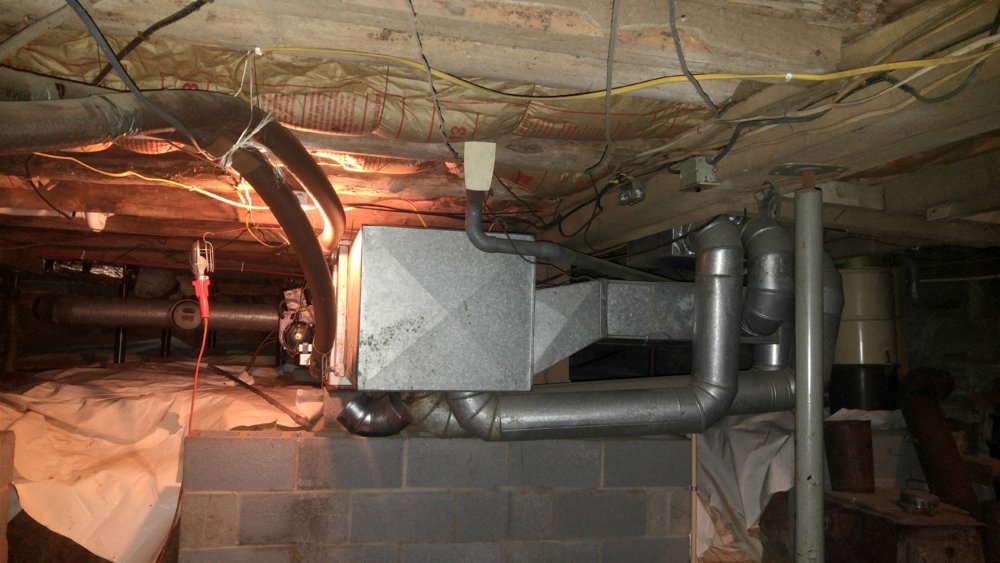

Behind the oil furnace is a air handler.
Behind the air handler is a water exchanger for the solar/water stove.
In front of the furnace is the air conditioning unit.
Water. Oil, Air. Lovely.
Now that's just the vitals she extends her reach through numourous passage ways. All narrow, crooked and painful to access.
So here is the skinny. House is old big and drafty. Original foot print 1890. Has 8 different chimneys and none are useable.
Water stove is 20 plus years old. No one has ever kept chemicals in it so it sprang a leak in the box. Already fixed the in-laws this last year. Same problem same owners, duh! Now the system over here is even older. All the plumbing is subject. Box is most likely shot, as in rebuild entire stove. Leading to plumbing overhaul throughout.
The air conditioner is also about the same vintage. Also gets a yearly tune up. In other words they keep patching at it too.

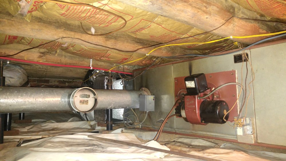

And last this here furnace is being irregular. Main control went last year.....replaced with....you guessed it something laying around. It's current tantrum has me, purplexed. It will cycle 5 Times maybe 8 but sometime another kicks out. Has a rumbly start and both motor and main control trips. Most concerning is some oil coming out from unburnt deposits. I've baby sat this thing for hours and she want kick out for me.
I do know the tank is buried and not a strainer or antisiphon to be found. Gravity drain. Strainer, nozzle, and points are going to get cleaned next. Furnace is by far the oldest piece.
The entirety of the house is a result of three or more generations patching and adding too. All with the least expenditure possible.
The whole house has 30 plus hand made jacks supporting the floors. The interior of the conditioned living space is actually quite nice.
However me and the wife agreed no amount of money will make it right for us.
Literally the old front porch is now our only restroom and living room. Its so arbitrarily arranged we can't have more than 3 or 4 guest without over crowding. A large portion of the house still isn't heated or cooled.
So we intend to build......luckily for me a shop comes first.
BUT WE HAVE MEDUSA.
So, we still need heat. Will definitely need air. Projected build for our home......estimated 10 years. Realisticly maybe 15.
So what in the hell do I do with this big ugly monster.....
Does anybody have a cleaner simpler solution?
Keep in mind a heat pump will spin for ever and not keep up. When the water stove is right one load in the unit a night keeps us toasty.
Would a gas pack be better? Conditioned air and heat back up?
As a note we intend to possibly restore this Old girl back to here 1890 luster. Meaning all modernist updates and additions removed.
So anything added would be great for the new house or shop.

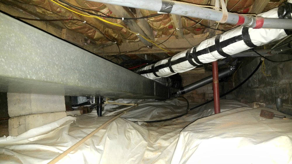

If you look close everything under the house is basicly tender. All of the old floor beams are hand hewn stripped pine logs. Several suffured infestation. Everything else is rough cut add ons and bracing of all sorts and efforts.
This is why I haven't considered a direct mount unit in the crawl space basement.

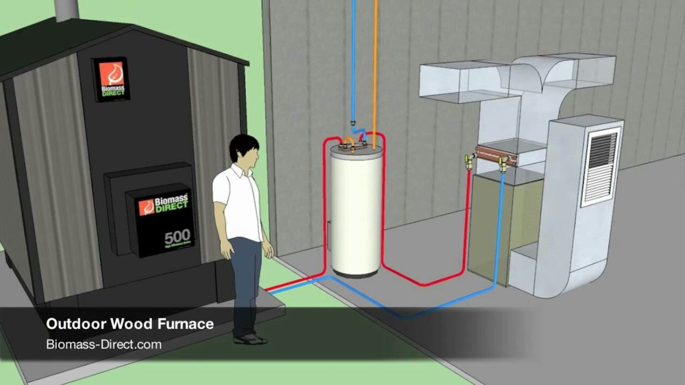

Outdoor stoves are basically outdoor boilers. You but a radiator inside the box for your heatpump. As long as the radiator is hotter then what is needed the heatpump won't turn on but the fan will turn on and circulate the air threw the house. That may not be explained right I'm looking for a picture

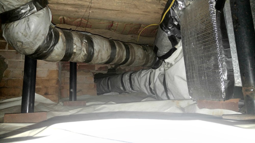

Water radiator exchanger, oil furnace, then air conditioning condenser. All in one trunk line. With one air handler trying to blow through all that stuff.
