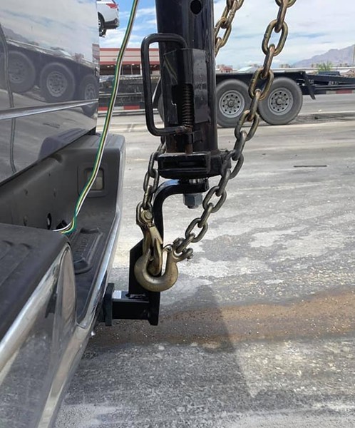

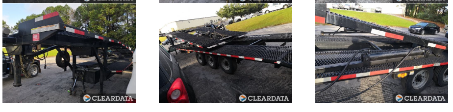

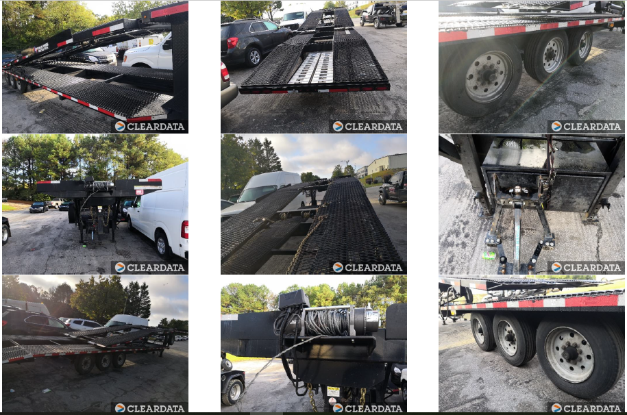

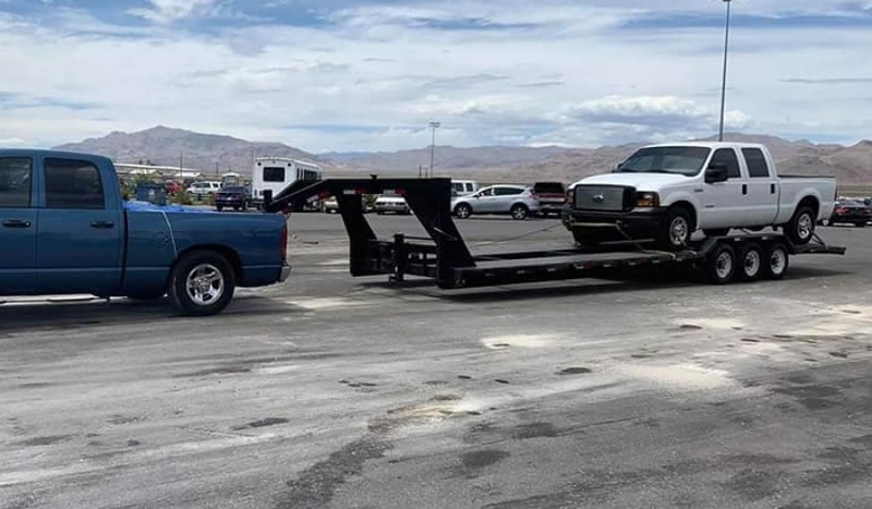

    Ok, thinking about buying a car hauler type trailer, pulls 3-4 cars or so, and it is a "fifth wheel" type trailer (Pics below) I think this means it normally uses a ball, mounted in your bed of truck over your axle, on a dually, etc.
    What I am wanting to do is just MOVE the trailer by itself around as needed and do NOT want to actually install the ball in my truck bed. So this would be a trailer by itself, NOT loaded with cars!!!

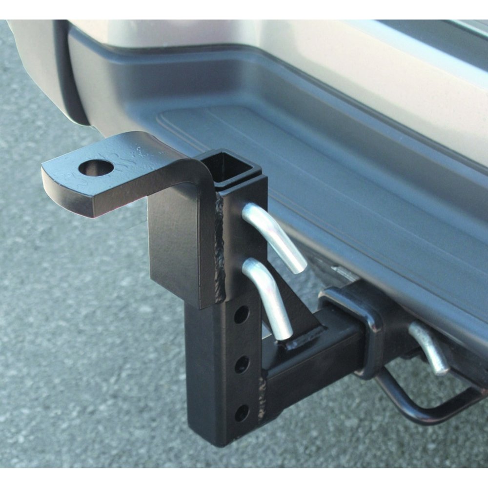

    So my question is this... could I use one of those adjustable ball mount hitches in my normal receiver to put a ball up to the same height as my pickup bed and move it around that way?
    My worry is 'leverage' in that the weight on the ball is likely higher than normal and of course we are now hanging this behind the truck instead of over the rear axle? What say ye?

    Gooseneck is the word you’re looking for. Technically a 5th wheel and a GN are different.
    If you get a turn over ball in the bed, you’re literally looking at 20 seconds to simply flip the ball over and be ready to use it. Flip it back over to be flush when you’re done. Then, hooking up is simple and fast to move and drop the trailer. Hooking up a GN is actually way easier and faster than a tag along cause you can turn around and see the ball.
    It’s really not hard and trying to make a way to move it from your hitch is making it way more complicated than it needs to be. Just get a B&W turn over hitch for the tow rig.

    If you want to pull it straigh forward 3' in yoru yard.....maybe.
    If you want to turn at all or hit a public road HELLLL Nawww Cuz
    Keeping the trailer frame off the tailgate/bed toe plate is going to be fun if not impossible.
    And as said above make 100% sure you understand th diff between a 5'er and a gooseneck...that changes eveyrthing.
    rodney eppes and braxton357 like this.

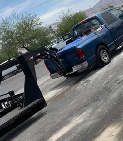

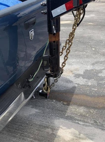

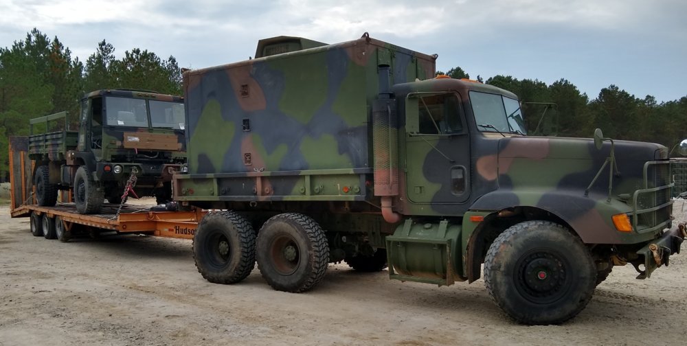

    Ok, some great pictures there CasterTroy that is what I wanted to see! I was thinking about the tailgate / if I would have to remove it but that looks like it would not be an issue. In that case the truck on the back of that trailer is putting some tongue weight onto the truck / which is causing the sag. (Looks like his bed is full too)
    This comes from my trailer rental biz (very similar to the thread in general chit chat where I was working with Mike to secure HIS trailer!) and if I needed to go get a trailer and move it from one lot to another, back to my house to work on etc. I am guessing that the trailer / tongue weight / unloaded will not exceed the 1/2 ton capacity of my Tundra.
    Does it look great...no, but it does appear possible and "done all the time with great success" is also good to hear!

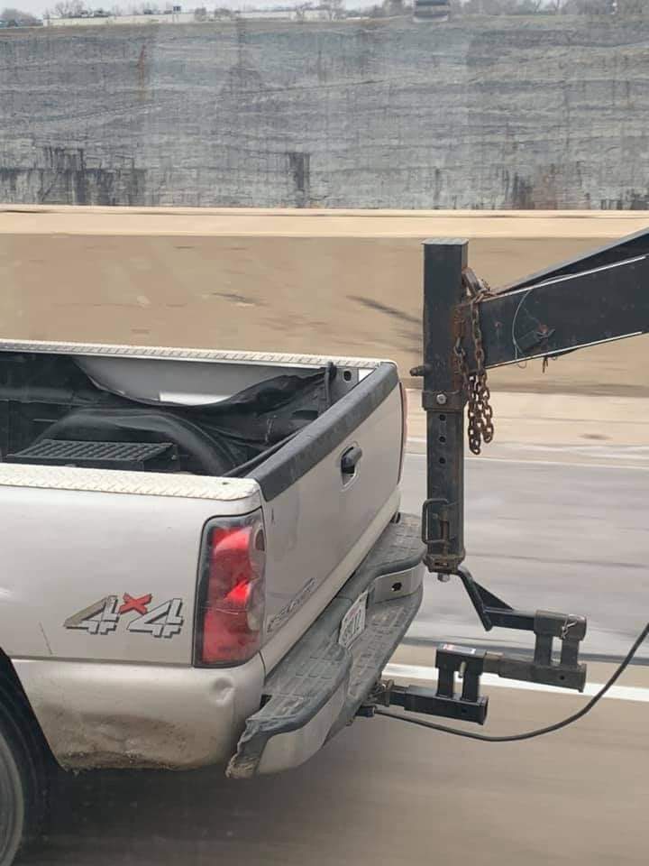

    The way that truck is loaded over the trailer axles it looks like it's either neutral or taking weight OFF the tongue. You need to know the tongue weight rating of your hitch and the unloaded pin weight of the trailer and decide from there. The tongue weight rating of my 1/2 ton truck is somewhere around 800lbs.
    Even then, I wouldn't hit a road with it. I don't know how people get away with stuff like that but I'd be under the jail if I even thought about it.
