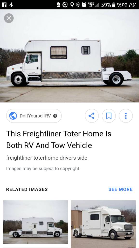

I do want a GN but it won’t go behind the RV. I guess it would fit on a toter with a GN deck but I’m also using the RV for camping and as a temporary residence while working out of town. The toter with GN deck isn’t as beneficial for 75% of the use of the RV

I think to just need one if these
