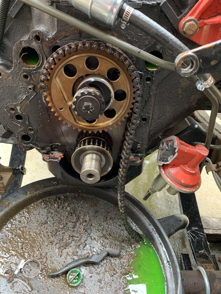

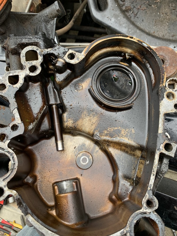

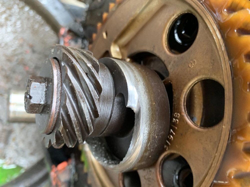

Pulled the front end off the engine this AM and found this:
Cam gear is nylon!
Timing chain: broken
Fuel Pump Eccentric: destroyed
Fuel Pump: roasted

• Does the cam drive gear (the one that drives the distributor) look like it needs replacing? It seems like it has some pronounced wear.
• The fuel pump arm hit the timing cover and gouged it (about dead center); it didn't break through, but should I still replace it?

• How do I retime the engine since the crank has spun since the chain broke? Is it as simple as lining the timing marks on the timing gears up after finding TDC? Or is there more to it than that?

If the cover isn't cracked or worn through don't worry about it. If the dist drive gear doesn't have missing pieces of teeth or nicks on the teeth you can skip it too unless they're dirt cheap. Definitely replace the chain, fuel pump and eccentric.
If it's not a high performance build then a stock replacement timing chain and gear set from any parts store will be fine. They should all have a steel gear for the cam. I don't see any missing teeth on yours though so that's good.
