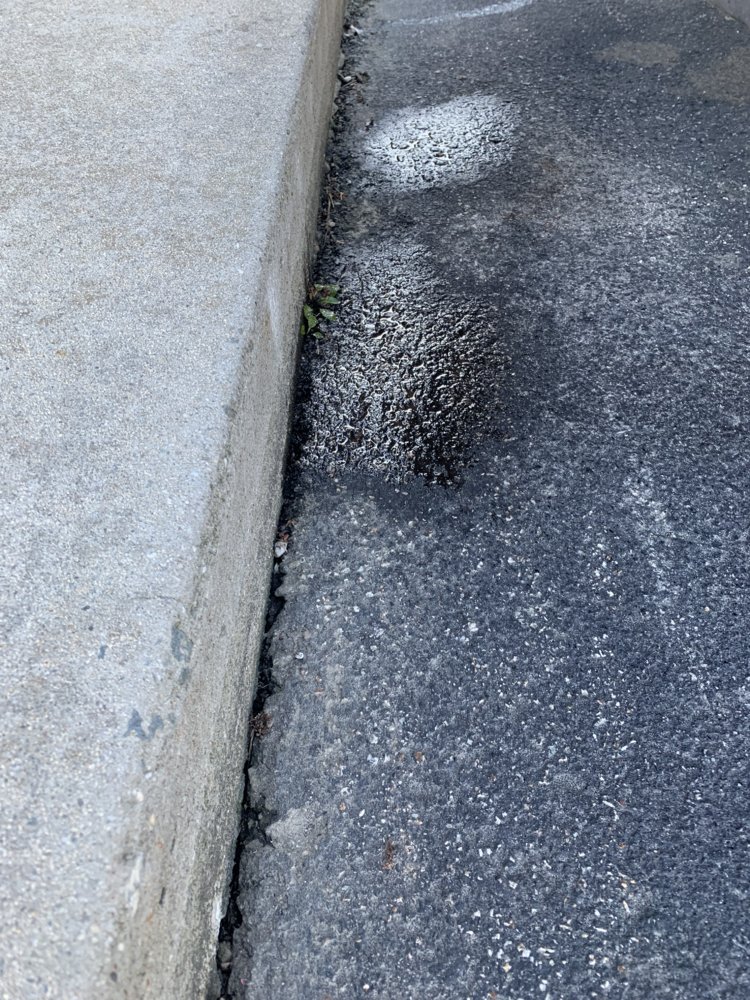

    Been leaking coolant for a while. Month maybe?
    I kept driving it cause my tuner can read the temps and I couldn’t figure out the leak. Never gets over 195 deg
    I have not added coolant until today. I added a gallon and it didn’t even fill up into the reservoir.
    I think I should fix it. It’s kinda leaking pretty bad.
    It leaves a puddle under it when I come out every morning but does not drip once truck is warm.
    It’s on the drivers side where it shows up the most.
    I came out from work and there was a pretty steady drip.
    Any advice? See pics

    Possible a cold leak, we see this a lot on machines. However its blamed on worm style clamps. The constant spring type clamps are much better and really dont see it much with them.
    Have you checked the basic stuff? Hoses& water pump?

    The 6.7 has somewhat of a habit of having radiator leaks

    Yeah, it’s not the radiator that I can see. I know they are common. It’s further back towards the motor.

    I’ve checked the hoses that I can see. These new things are so congested. I’ll have to tear off some junk to see below.

    If they're anything like the F150s and have the multiple piece upper radiator hose, it's probably that. Leaks when it's cold because of the plastic housing.

    You check the coolant inlet to the turbo? Radiator is the most common, turbo coolant inlet 2nd, upper Hose 3rd.

    I think you’re right here. Cause I only drained one of them to delete it.
    And that reservoir hasn’t budged. It’s the smaller circled one.

    Yes, there's a high-temp system for engine coolant and a low-temp system for the air/water intercooler, trans cooler, etc.

    I guess I really need to pressure test it and see what gives. But do it when it’s cold.
    I’m hoping it’s not the water pump. That’s gonna be a bear.
