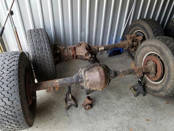

These are the super duty axles that I found on Craigslist for $800 for the pair.
Sent from my SM-G920T using Tapatalk

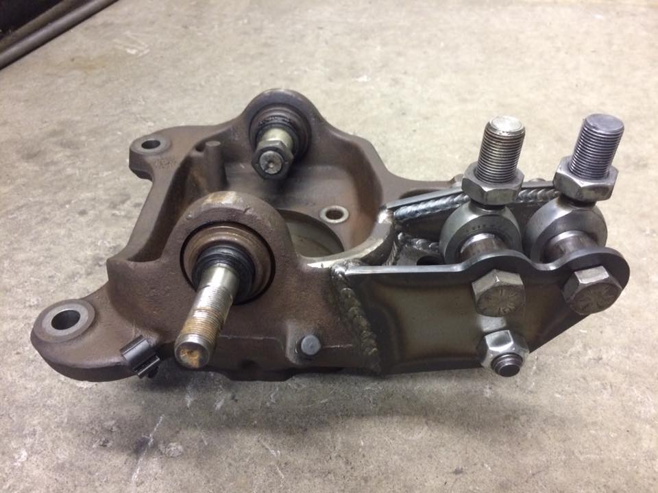

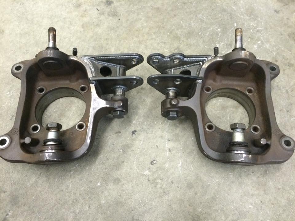

Check out the Jesse Haines Fabrication steering arms. They weld on the knuckle and are a lot more affordable than a traditional high steer arm. Just message him on Facebook if you are interested.
Not worried about joining two dis-similar metals?
ahhh that makes it not sketch now lol

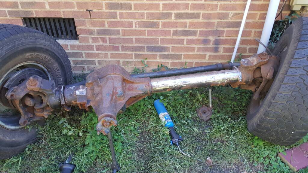

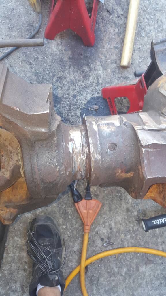

This was about the halfway shot on cleaning up this beast. Lenox gold thick metal blades, and a big 6-7in grinder are the only way to clean these without pulling your hair out. My little 4.5in just didn't have the power.
Rear axle all cleaned up, time to take them to Preformance 4x4 tomorrow!
finished up the front, this last little bit was hell, I had to use the grinder to cut the welds, a hammer and chisel to free it up then use the grinder to cut the chunks off.

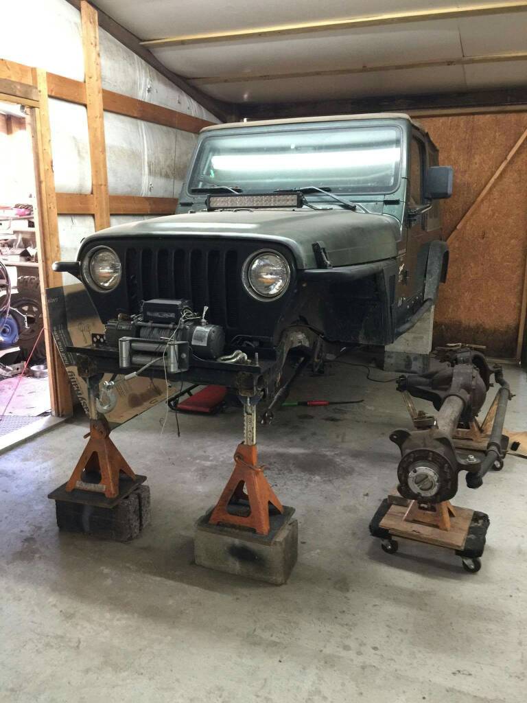

Truck is finally going again and running good, just got a picture of the jeep at Preformance

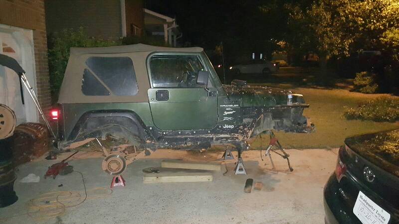

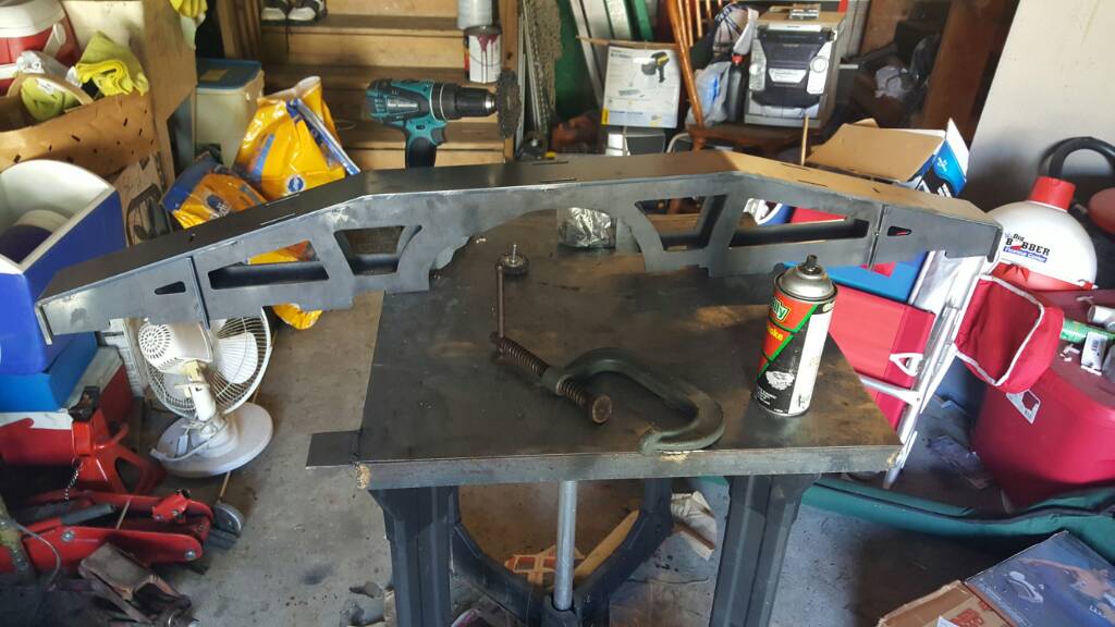

Time to bump this thread again, the barnes sterling truss will not work, so going to have to sell it and custom build one. The artec truss also will not work, that will also have to be custom made. The jeep has been stripped down and is ready for the next step. The jeep will hopefully be a roller in less than a month.

What was wrong with the sterling set up from Barnes? We used one on a build at the shop.
There are 2 main issues with it, there are 3 pieces to the truss, 2 sides and the top. There isn't any bracing between the 2 sides. You would have to add braces to it to lock them together in the middle. If you notice how the artec trusses have gussets to lock the back bone and tubes together to prevent any flexing. Also the height of the truss at the ends would raise the coilovers about 2.5 to 3 in above the tubes. It would make the back of my jeep sit higher than I would like.
