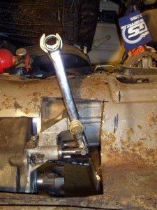

Next steps are gonna be easy. Measure up about 1" from the cut end of the wrenches. Drill a 5/16" hole in each wrench. Now, measure up approx 2.5" and drill another 5/16" hole. This will become a pilot hole. Next you will need to open up that pilot hole to 5/8". See where we're going with this? The hole at the bottom will connect to the rails and the big hole with be the pivot...easy stuff.
Step Five
Now we get to burn a little steel. Insert the 5/16"x 1.5" bolts into the rails where you drilled the holes earlier. The bolts will point towards the case. Once the bolts are placed square weld them to the rails. You can even weld into the factory hole for a little rosette action.
Step Six
Now you will get to see it all come together. Slide a wrench onto each of the recently welded bolts and secure with a nylock nut. Rotate the wrench upward so the 5/8" hole lines up with the 5/8" hole in the pivot that you drilled in step 1. Slide the 5/8" x 5" bolt through the wrenches and the front output housing.
Step Seven
This where I tested each position for function. I did do a little grinding here and there, opened up a hole here and there, etc. Once I was satisfied with the results, I pulled the big bolt out and reinstalled it with an appropriately placed mixture of nylon washers and the 5/8" sleeve cut into random pieces.
